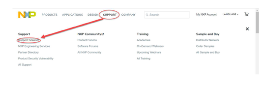

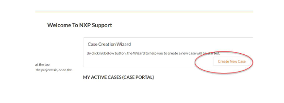

I can't find where to create a ticket via the case portal
4,880 次查看
Kan_Li
Hi @marcocavallini ,
Please kindly refer to the following for details.
Hope that helps,
