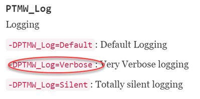

Which variant of SE05x was used in your test? Have you tried to rebuild sssapisw within the MW with the verbose log level? It would be very helpful to have the log during this issue.
