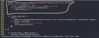

Hey @Kan_Li
I created a simple HMAC calculator which was working fine.
And after couple of days it suddenly stopped working.
Please check logs from accessManager and client application in screenshot below.
It says,
CreateCryptoObject Failed
among other more generic warnings
After further debugging I found out that the sss_mac_init is failing.
I am only using sss_key_*, sss_mac_* and ex_boot_* apis for now. none of them are exposing CryptoObject or requiring it as input.
I was not able to get around this, i had to factory reset the chip with se05x_Delete_and_test_provision and then again provision the key with same keyId
I am not able to reproduce this issue again. Any pointer on what can cause this would be appreciated.
From the documentation it is not clear what CryptoObject is being used for. More details on this would be a great help.

Hi @bug_squasher_77 ,
Actually it is hard to trace the root cause with the log from Access manager, do you have log from the client? If  se05x_Delete_and_test_provision can solve this issue, maybe due to running out of memory for secure objects storage, did you create new secure objects in SE051 in your code? Have you deleted them by the end of the program? or have you accidently disabled new objects creation on SE051?
Please kindly clarify.

Kan_Li
Thanks for the information! I am digging into the source code and suspecting maybe your issue happened there as shown below:
so most likely your code tried to update some secure object created by another user and failed to do that due to the policy.
Please kindly check from your side if the object ID is duplicated .
Hope that helps,
Kan
