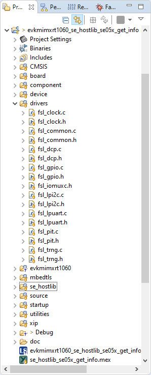

Change application source files
The hello_world demo for RT1060 is imported into MCUXpresso IDE using the default project settings.  The new project is renamed evkmimxrt1060_se_hostlib_se05x_get_info.  Then the following changes are made:
Removed:
Source/hello_world.c
Copied the following source folders from evkbimxrt1050_se_hostlib_se05x_get_info:
Doc
MbedTLS
se_hostlib
source
For the RT1060 app, I kept these files from hello_world:
Board
CMSIS
Component
Device
Drivers
Startup
Utilities
Xip
And added these additional driver files used in the RT1050 example from \SDK_2.7.0\devices\MIMXRT1062\drivers to project \evkmimxrt1060_se_hostlib_se05x_get_info\drivers
fsl_dcp.c
fsl_dcp.h
fsl_lpi2c.c
fsl_lpi2c.h
fsl_pit.c
fsl_pit.h
fsl_trng.c
fsl_trng.h

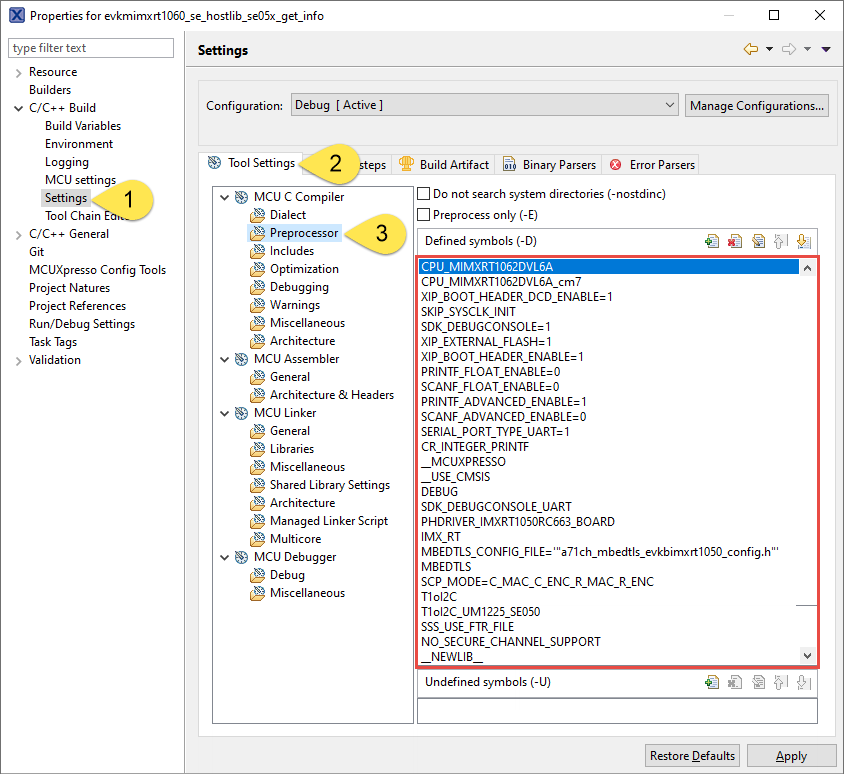

Copy project preprocessor definitions
The se_hostlib uses many preprocessor definitions to configure the library.  Updated the project properties for the compiler preprocessor definitions from the RT1050 example are used, and made the following changes to the RT1060 project:
Added:
SDK_DEBUGCONSOLE_UART
PHDRIVER_IMXRT1050RC663_BOARD
IMX_RT
MBEDTLS_CONFIG_FILE='"a71ch_mbedtls_evkbimxrt1050_config.h"'
MBEDTLS
SCP_MODE=C_MAC_C_ENC_R_MAC_R_ENC
T1oI2C
T1oI2C_UM1225_SE050
SSS_USE_FTR_FILE
NO_SECURE_CHANNEL_SUPPORT
__NEWLIB__ (MCUXpresso IDE does this automatically with the linker changes below)
Changed:
PRINTF_ADVANCED_ENABLE=1
Removed:
__REDLIB__ (MCUXpresso IDE does this automatically with the linker changes below)

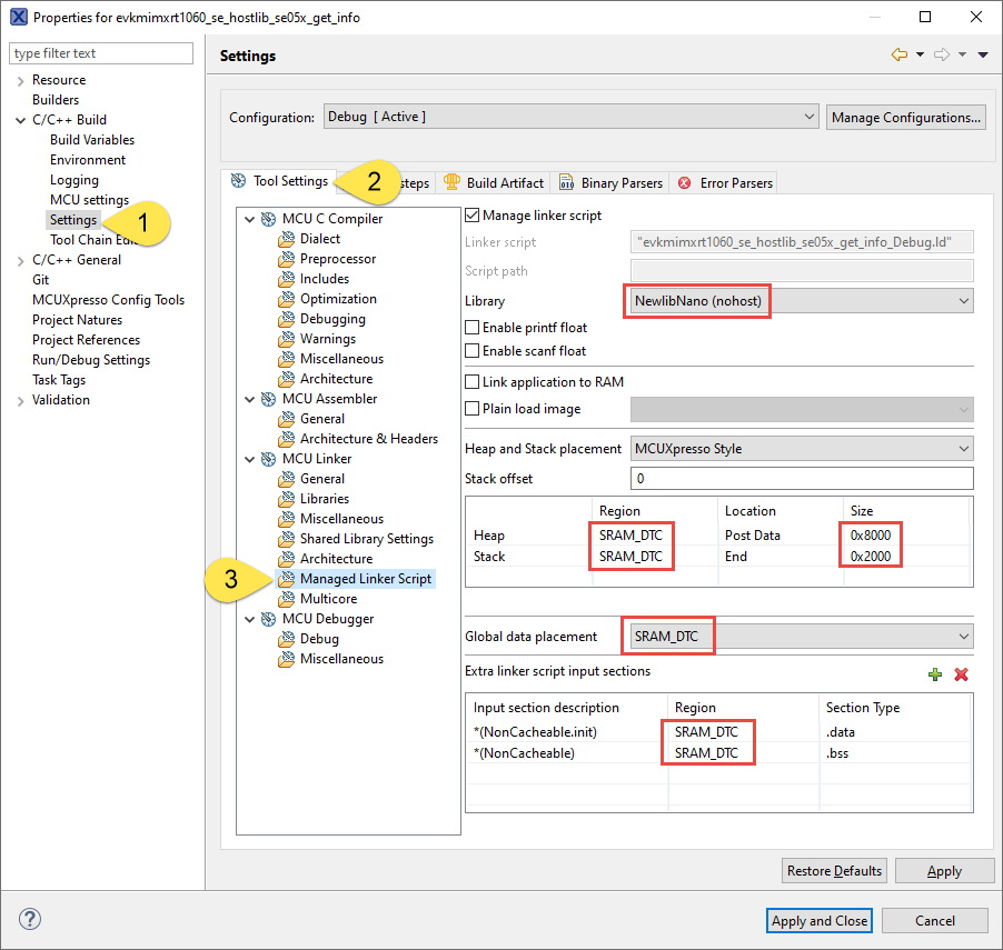

Change linker settings
Based on the preprocessor definitions above, I realized the RT1050 project used the NewLibNano runtime library in the IDE.  The linker settings were updated to change the library from RedLib to NewLibNano (this step could have been done during the SDK project import into MCUXpresso IDE).  Also the linker placement of all RAM is changed to the RT1060 SRAM_DTC region, and heap and stack sizes updated to match the RT1050 example.

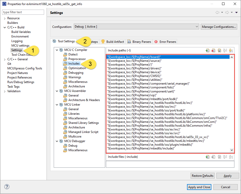

Change compiler include paths
Added the following paths for se_hostlib and mbedTLS to the compiler includes:
"${workspace_loc:/${ProjName}/mbedtls/port/ksdk}"
"${workspace_loc:/${ProjName}/se_hostlib/hostlib/hostLib/inc}"
"${workspace_loc:/${ProjName}/se_hostlib/sss/inc}"
"${workspace_loc:/${ProjName}/se_hostlib/sss/port/ksdk}"
"${workspace_loc:/${ProjName}/se_hostlib/hostlib/hostLib/platform/inc}"
"${workspace_loc:/${ProjName}/se_hostlib/hostlib/hostLib/libCommon/smCom/T1oI2C}"
"${workspace_loc:/${ProjName}/se_hostlib/hostlib/hostLib/libCommon/smCom}"
"${workspace_loc:/${ProjName}/se_hostlib/hostlib/hostLib/libCommon/infra}"
"${workspace_loc:/${ProjName}/se_hostlib/sss/ex/inc}"
"${workspace_loc:/${ProjName}/se_hostlib/sss/ex/src}"
"${workspace_loc:/${ProjName}/se_hostlib/hostlib/hostLib/se05x_03_xx_xx}"
"${workspace_loc:/${ProjName}/se_hostlib/hostlib/hostLib/mbedtls/inc}"
"${workspace_loc:/${ProjName}/se_hostlib/sss/plugin/mbedtls}"
"${workspace_loc:/${ProjName}/mbedtls/include}"
