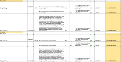

• SM4.REDUNDANT_IO is for ASIL D 99% DC?
For us, we required the DC corresponding to ASIL B.
In this case, which safety mechanism can be alternative instead of SM.REDUNDANT_IO?

ehtesham_khan
The ADC Self-test (SM1.ADC_SELF_TEST)- Periodic test of correct ADC operation, can be done in place of SM4.REDUNDANT_IO for ASIL-B application.
The ADC Self-test will not be able to run with the application, you'll have to stop the application and run this test, then resume the application. Run this test periodically, once per FHTI, to get sufficient coverage.
