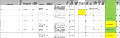

FXY
Single Point Failures for V15 and V11 pins should include both open and short.
I think the open circuit of V15 and V11 pins can be regarded as multi-point, and the redundant safety mechanism can be used, but short to GND is not suitable, because the hardware schematic design is in a short-circuited state outside the chip, as shown below, V15 and V11 pins share a set of capacitors and networks respectively.
So, to avoid Single Point Failures on V15 and V11 pins, what is NXP's recommended schematic design?
1. Need to consider circuit isolation in schematic design between pins?
2. External monitoring?
3. Other recommended security mechanisms?

nxf55526
Hello Kevin,
'Short to GND' here refers to the short between the V15/V11 pin and the VSS pin which is the ground pin in the package and could get shorted to V15/V11 pins. V15 power supply is being monitored externally and the short of this pin to GND would get detected by the external monitoring, while the short of V11 pin to GND would get detected by the internal voltage monitors present in the chip.
Hope this clarifies the doubt.
