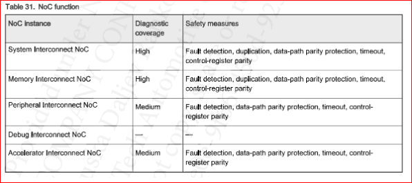

From the above block diagram, it is clear that,  Accelerator Interconnect NoC is interfaced with System Interconnect NoC.
Q1: As per our knowledge , Accelerator Interconnect NoC is only used for the communication over PCIE, PFE and USB and it’s not used for any other communication. We would like to understand from NXP whether the above statement highlighted in bold is correct.
Justification for disabling this NCF in FCCU config:

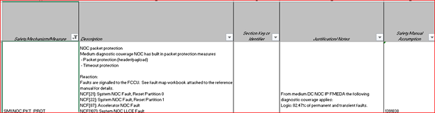

From the below table we can see that Accelerator Interconnect NoC is having diagnostic coverage as Medium. And with reference to the NXP assumption(snippet added below), we should have E2E protected communication to claim the functionality as safety relevant.
This means , if Accelerator Interconnect NoC is only used for communication over PFE then we can claim the communication as safety relevant based on E2E protection.
Question related to safety impact:
Q2: When considering the below mentioned safety mechanism(Refer snippet below) with respect to NOC, we would like to understand the safety impact of disabling NCF[87] on the coverage of SM1.NOC.PKT_PROT. Also we would like to understand whether the below mentioned mechanism is only for  “Accelerator NOC” or its for the entire NoC which includes “System Interconnect, Memory Interconnect, Peripheral Interconnect, Debug Interconnect, Accelerator Interconnect”

"If you only use PFE from the ACCEL partition for safety relevant communication and the safety-related data are already traveling from the ASIL partition through the ACCEL NOC to the PFE with E2E protection already applied, then you can consider both ACCEL NOC and PFE as QM peripherals and NCF[87] as well as other NCFs from PFE can be disabled."
The extract from the Safety Manual below is stating that HW mechanisms within the ACCEL NOC are not sufficient for ASIL D safety-related data.
"If ASIL D data does need to be transferred through the implemented medium diagnostic NoC, end-to-end protection should be used [1391838]."
If E2E protection is applied within the ASIL partition then the NOC can be considered QM.
