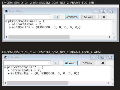

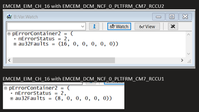

Hi Team,
Our customer Nexteer is having difficulty decoding the eMCEM_FaultContainerType and the corresponding au32Fault values. They are not sure how to align them with the Fault list in 3.9.3.1 S32K3_SPD_EMCEM_UM.
Also is there reasoning for there to be 6 elements in the array and what do they map to? Are they supposed to represent the NCF slots or something else?
Below are some of their examples:

the au32Fault array has six elements which correspond directly to HW registers DCMROD3, 4 up to 8 in DCM_GPR HW module. The mapping is as follows:
au32Faults[0] -> DCMROD3
au32Faults[1] -> DCMROD4
au32Faults[5] -> DCMROD8
For example in above screenshot there is value 8388608 (0x80000000) in au32Faults[0]. This corresponds to bit 31 in DCMROD3 register which is
CM7_1_ICDATA_ECC_ERR bit (Cortex-M7_1 I-cache Multi-Bit ECC Error).
Frantisek

Hi @frantisekdobes,
Thank you for the clarification this makes a lot of sense.
I think you had a typo 8,388,608(dec) = 0x80 0000
so the error screenshotted with the api calling PRAM2_ECC_ERR correctly shows bit 23 in DCMROD being set.
