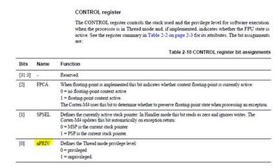

Switching between both Thread Privileged/Unprivileged can be done inside the SVCall,  where SVCall is an exception that is triggered by the SVC instruction.
Inside the SVCall handler user can switch between Privileged/Unprivileged modes by writing the nPRIV bit in  the CONTROL register, see below.
More details can be found in the Cortex™-M4 Devices Generic User Guide, which can be downloaded from ARM pages.

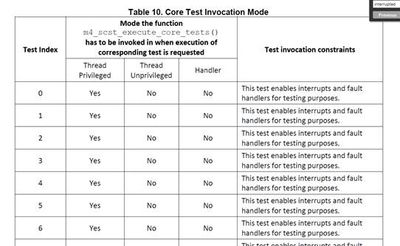

The Cortex SCST Library uses it’s own interrupt vector table for dedicated tests only (Test ID 0-15). In case of these tests are interrupted by an ISR coming from the User Application the SCST Library is able to detect this “alien” interrupt and to forward it back into the User Interrupt Vector table. In such case the SCST API returns the M4_SCST_TEST_WAS_INTERRUPTED return value. Note, that this forwarding mechanism introduces some ISR latency which is documented in the SCST UM.
Second group of tests (ID 16-18) does not replace the interrupt vector table, but it disables all interrupts for some limited time, the ISR latency is also documented in the SCST UM.
Third group of test (ID 19-43) does not replace the interrupt vector table and does not disable interrupts. Documented latency is 0 for these tests.
The problem which I could observe is you execute some tests in ISR (Handler mode)?, see below
But if we disable MPU and run SCST in main loop (not in ISR), this failure will not happen….
Note, that invocation of some tests is not allowed in the Handler mode, as it is documented in the SCST UM, please refer to Table 10 Core Test Invocation Mode.
Hope it helps.
