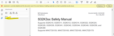

Addendum_S32K3xx.xlsx excel sheet attached in the SM.
