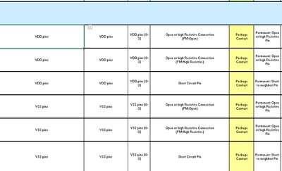

Do we have the respective Pin failure mode list and ratios for Input Pin, Output Pin, Analog Pin and Power Pin?
My customer use S32K16.

Hi Hornby,
Yes the FMEDAs have considered the PIN failure modes. Following is an example from Power FMEDA of S32K146 below
Hope this answers your concern.
