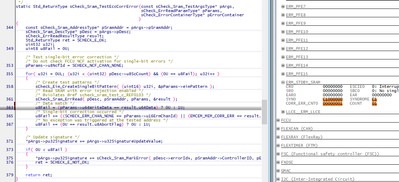

Dear Support Team:
We have a problem in use  Scheck SRAM function。

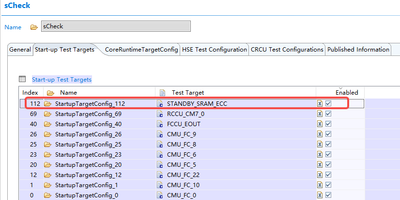

The EB configuration is as follows:

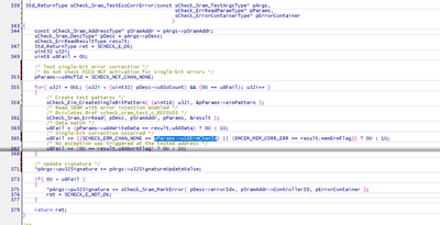

We catch an exception in sCheck_Sram_TestEccCorrError test.
The function returns wrong result at line 365
Data in watch window:
pParams->u16ErmChanId = 0x129,
result.memErmFlag = EMCEM_MEM_NO_ERR
Line 375:*pArgs->pu32Signature = 0x5E338001
How can we do to perform the correct scheck_ecc test?

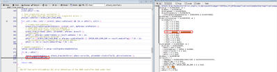

Could you check whether the error is injected properly by checking the ERM instance as in the following screenshot from Lauterbach debugger:
I.e. after executing the sCheck_Sram_ErrRead() function you should see one correctable error detected in ERM_STDBY_SRAM HW module. The function sCheck_Sram_ErrRead() function will setup EIM (Error Injection Module), then it will perform a read from STANDBY SRAM to create the ECC error so after this we should see the error detected in ERM_STDBY_SRAM error reporting module.

It would generate BUS Error when runned in 'sCheck_Sram_TestEccUncorrError' as attached.
Could help to check it, please?
Thanks a lot.
4,903 Views
martinkaspar-r3
it seems that the debugger is getting BUSERROR message when it’s trying to read the value of the local variable “result” inside the function “sCheck_CortexM7_ErrRead”. Also the address 0x1 of the argument pParams for the function seems to be incorrect. This indicates that there might have been stack corruption. Is any EIM peripheral enabled (EIM.EIMCR.GEIEIN=1) when you observe the error?
