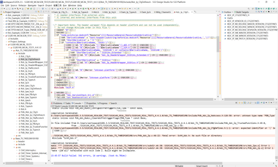

We want to package the MCAL generated by SW32K1_RTD_4.4_1.0.0 as an SDK and import it into S32DS3.5. But when compiling in S32DS3.5, there were a lot of errors.
We refer to the steps in the attachment. How to solve this error ? Could you please provide us with the latest instruction manual to us ?thanks.
1,275 Views
Yashwant_Singh
Apologies for the delay. We requested the software team's input on this issue and it looks like the S32K1 RTD 1.0.0 isn’t compatible with S32DS 3.5. It’s only developed in S322DS 3.4. See the following info in the Release Notes:
