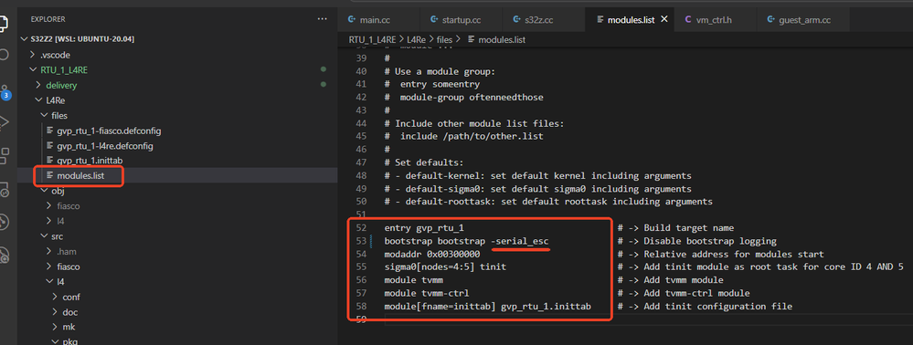

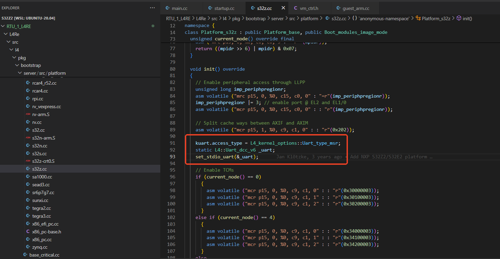

I see initialization code in s32z.cc for DCC UART in the bootstrap for the S32Z platform. So how to use DCC UART output in S32Z280-594EVB?  How to use J-Link to connect and configure, then view DCC log output?
If J-Link cannot be used on the S32Z280-594EVB, how should I output printf logs through serial port in (hypervisor)bootstrap and fiasco?

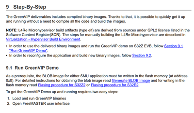

Debugging the S32Z280-594EVB development board usually involves using the S32 Debug Probe and the Lauterbach debugger.
For more information, please refer to step-by-step of S32ZE_GreenVIP_1.3.0.
Joey

So is there no way to output printf logs through DCC in L4Re? Or can printf logs be output through S32 Debug Probe or Lauterbach debugger?
