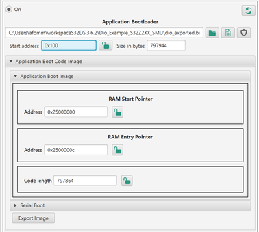

  2. Created an IVT image using the S32 IVT Tool
    • Selected the LED example application (which works when debugged via Lauterbach).
    • This is the configuration:
  • After configuration, I pressed the "Export Image" button in the Application Bootloader section to update the image blob.

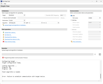

The error that I'm getting all the time from the flash tool.

I have also tried to flash to the QSPI Flash by connecting to the J119 USB with this configuration:
RCON switches:
J1245 and J125 in serial mode:
I got the same error with the Flash Tool:
Am I doing anything wrong?
