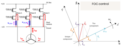

This example demonstrates a 3-phase Permanent Magnet Synchronous Motor (PMSM) vector control (Field Oriented Control - FOC) drive with single shunt current sensing with and without position sensor. This design serves as an example of motor control design using NXP S32M276 automotive family.
The example was designed on:
C-project based example is a part of:
  • S32M27XEVB-SW application SW for S32M27xEVB
    Application software contains:
    • S32M27xEVB_PMSM_FOC_1Sh - Low-level drivers of RTD and S32 Design Studio Configuration Tools (S32CT) are used to demonstrate a single shunt FOC application. The detailed description of the example can be found in application note AN14482.
  • S32M276SFFRD_MC_SW  application SW for S32M276SFFRD
    • S32M276SFFRD_PMSM_FOC_1Sh - Low-level drivers of RTD and S32 Design Studio Configuration Tools (S32CT) are used to demonstrate a single shunt FOC application. The detailed description of the example can be found in application note AN14482.
