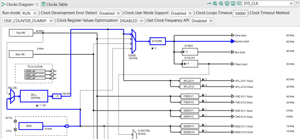

S32 Configurations Tool
     Clocks Tool
S32M244 and S32K144 features a complex clocking sourcing, distribution. To run a core of the S32M244/S32K144 as well as some MCU peripherals at maximum frequency 80 MHz in normal RUN mode, S32M244 is supplied externally by 16 MHz crystal (meanwhile S32K144 is supplied externally by 8 MHz crystal). This clock source supplies Phase-lock-loop (PLL), which circuit multiplies frequency by 20 in S32M244 (and by 40 in S32K144) and divides by 2 resulting 160 MHz frequency on output for both devices. PLL output is then divided by 2 to supply core and system (80 MHz), further divided by 2 and 4 to supply bus clock (40 MHz) and flash clock (20 MHz), respectively (See next Figure).
Figure 1. S32M244 Clocks Configuration

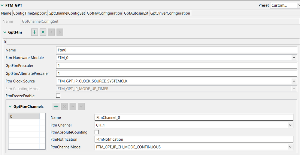

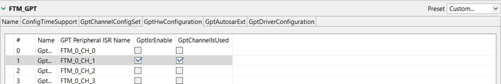

     Peripherals Tool
Below is the FTM GPT configuration (the default configuration of the tabs that are not shown is used):
Figure 3: FTM_GPT GptChannelConfigSet
Figure 4: FTM_GPT GptHwConfiguration

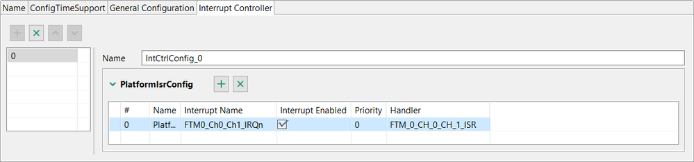

Figure 5: IntCtrl_Ip Interrupt Controller

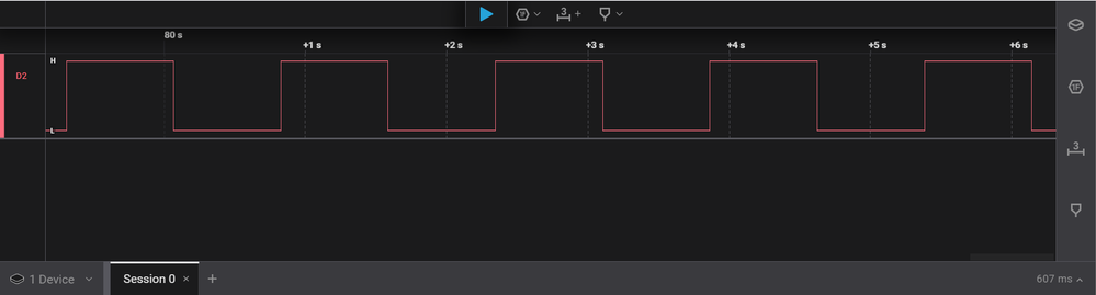

On the oscilloscope
Figure 6 shows PTD0 (D2) signal of S32M244 in the oscilloscope. Such GPIO is toggled when the FTM notification is called..
Figure 6: Global time base in S32M24x
