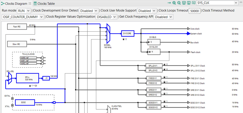

S32M244 and S32K144 features a complex clocking sourcing, distribution. To run a core of the S32M244/S32K144 as well as some MCU peripherals at maximum frequency 80 MHz in normal RUN mode, S32M244 is supplied externally by 16 MHz crystal (meanwhile S32K144 is supplied externally by 8 MHz crystal). This clock source supplies Phase-lock-loop (PLL), which circuit multiplies frequency by 20 in S32M244 (and by 40 in S32K144) and divides by 2 resulting 160 MHz frequency on output for both devices. PLL output is then divided by 2 to supply core and system (80 MHz), further divided by 2 and 4 to supply bus clock (40 MHz) and flash clock (20 MHz), respectively (See next Figure).
Figure 1. S32M244 Clocks Configuration

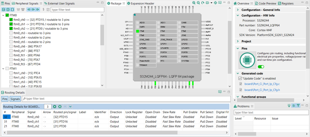

     Pins Tool
In Pins Tool are selected the signals to use the FTM0 module as follows:
Figure 2. S32M244 Pins Configuration

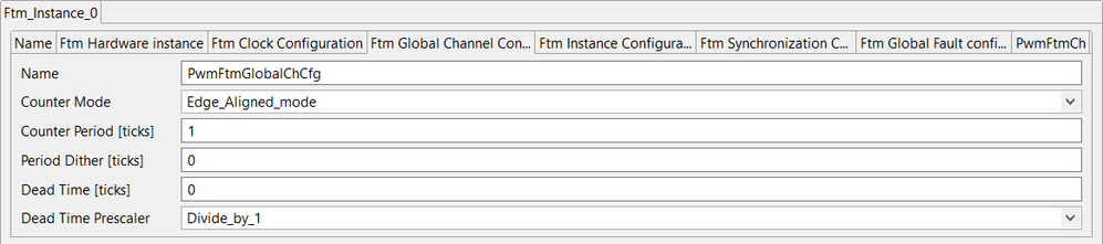

     Peripherals Tool

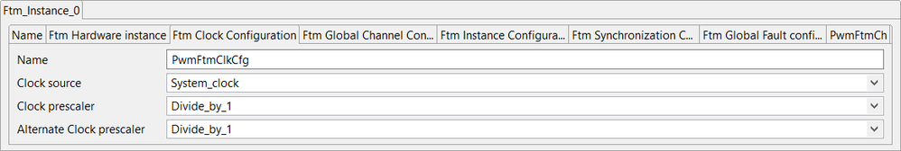

Below is the FTM0 configuration (the default configuration of the tabs that are not shown is used):
Figure 3: FTM0 Hardware instance
Figure 4: FTM0 Clock Configuration

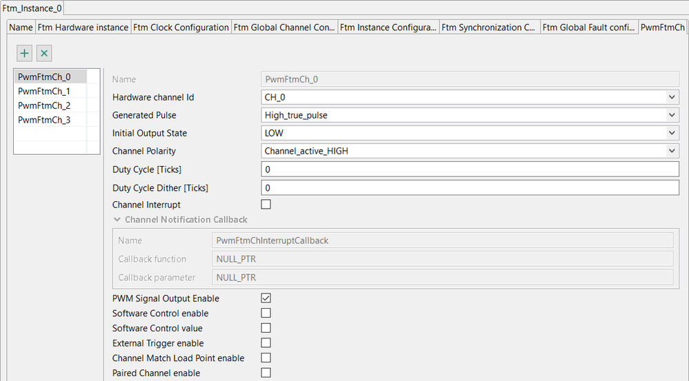

Figure 5: FTM0 Global Channel Configuration
Figure 6: FTM0 PwmFtmCh

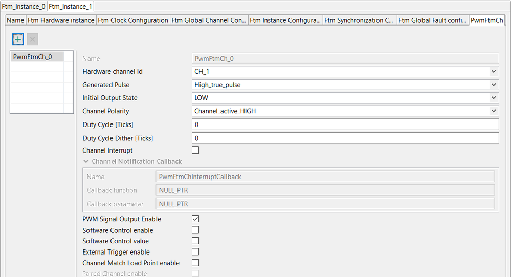

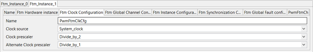

Figure 7: FTM1 Clock Configuration
Figure 8: FTM1 PwmFtmCh

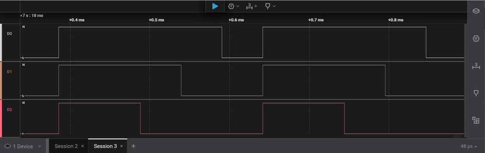

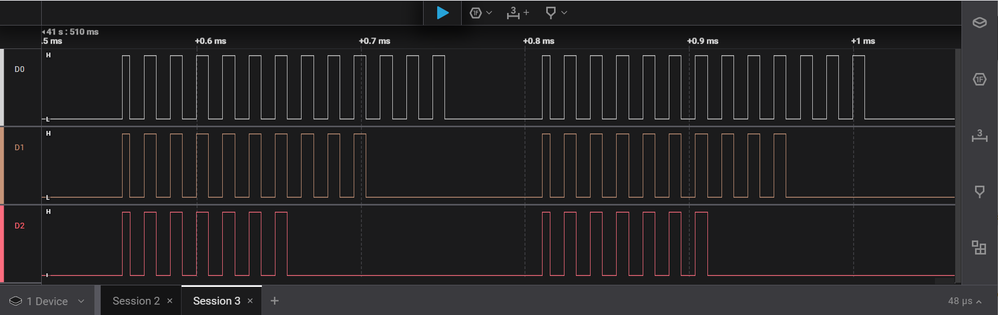

On the oscilloscope
Figure 9 shows ftm0_ch0 (D0), ftm0_ch1 (D1) and ftm0_ch2 (D2) signals of S32M244 on the oscilloscope. Such signals have the same period aligned in the edge, with different duty cycle and without PWM Modulation Implementation.
Figure 9: Edge-align PWM (EPWM) mode without PWM Modulation Implementation (in S32M244)
Figure 10 shows same signals from Figure 9, but now with PWM Modulation.
Figure 10: PWM Modulation Implementation (in S32M244)

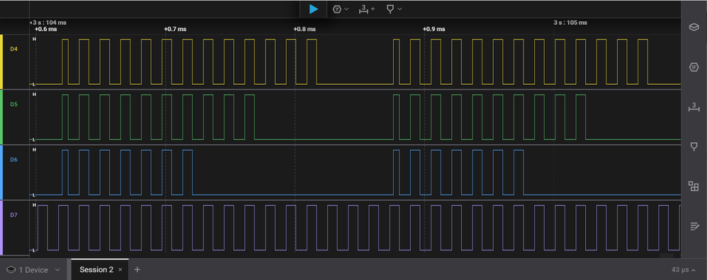

Figure 11 shows ftm0_ch0 (D4), ftm0_ch1 (D5) and ftm0_ch2 (D6) signals of S32K144 on the oscilloscope. Such signals have the same period aligned in the edge, with different duty cycle and with PWM Modulation. Additionally this device allows to route externally the ftm1_ch1 (D7).
Figure 11: PWM Modulation Implementation (in S32K144)
