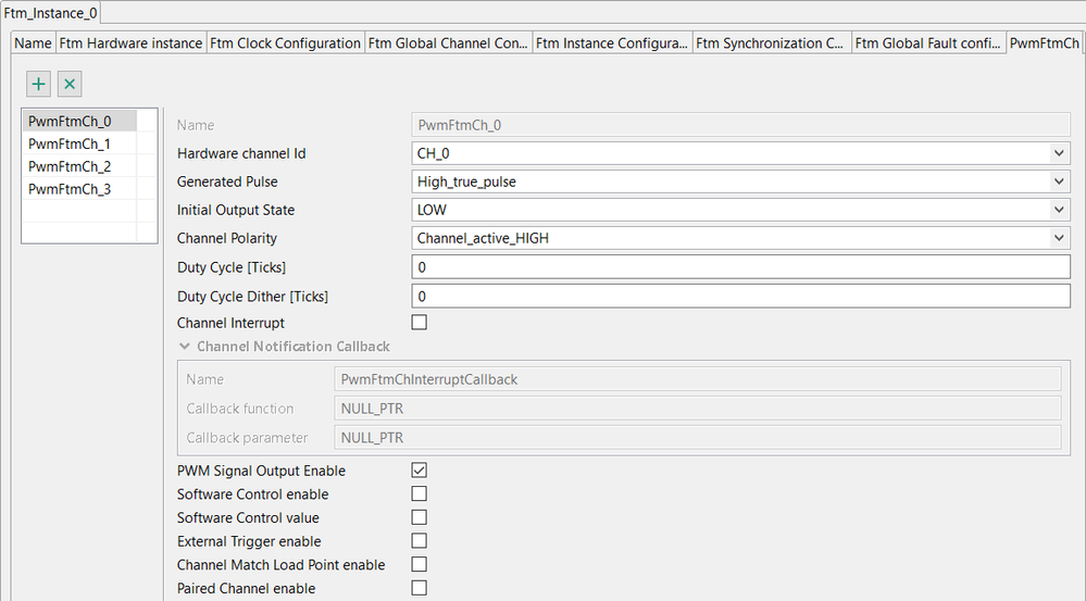

     Peripherals Tool
Below is the FTM0 configuration (the default configuration of the tabs that are not shown is used):
Figure 3: FTM Hardware instance
Figure 4: FTM Clock Configuration
Figure 5: FTM Global Channel Configuration
Figure 6: FTM PwmFtmCh

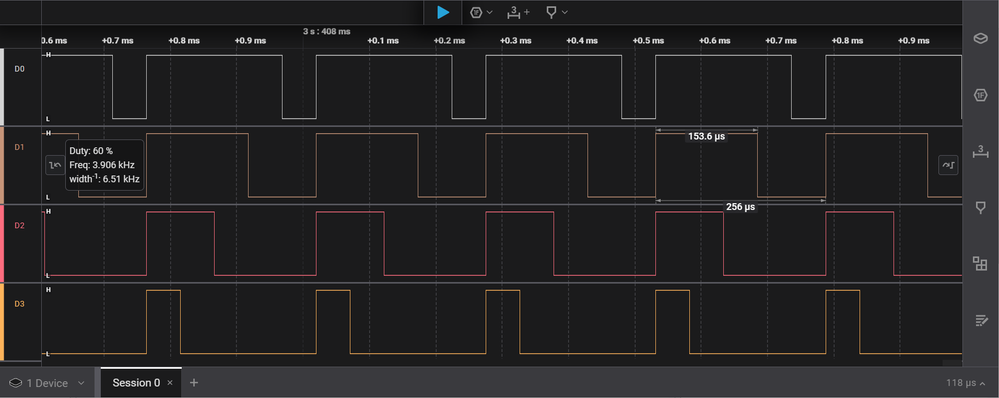

On the oscilloscope
Figure 7 shows that the ftm0_ch0 (D0), ftm0_ch1 (D1), ftm0_ch2 (D2) and ftm0_ch3 (D3) signals on the oscilloscope. Such signals have the same period aligned in the edge and with different duty cycle.
Figure 7: Edge-align PWM (EPWM) mode
