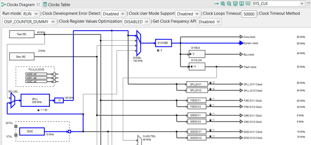

     Clocks Tool
S32M244 and S32K144 features a complex clocking sourcing, distribution. To run a core of the S32M244/S32K144 as well as some MCU peripherals at maximum frequency 80 MHz in normal RUN mode, S32M244 is supplied externally by 16 MHz crystal (meanwhile S32K144 is supplied externally by 8 MHz crystal). This clock source supplies Phase-lock-loop (PLL), which circuit multiplies frequency by 20 in S32M244 (and by 40 in S32K144) and divides by 2 resulting 160 MHz frequency on output for both devices. PLL output is then divided by 2 to supply core and system (80 MHz), further divided by 2 and 4 to supply bus clock (40 MHz) and flash clock (20 MHz), respectively (See next Figure).
Figure 1. S32M244 Clocks Configuration

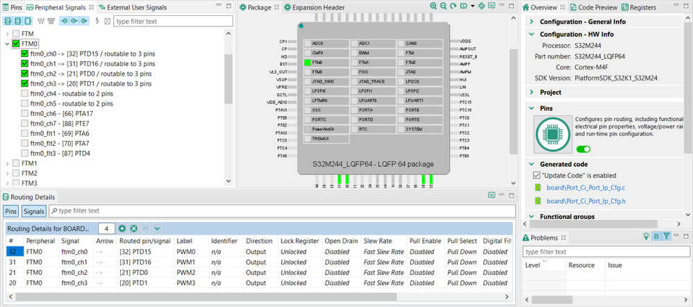

In Pins Tool are selected the signals to use the FTM0 module as follows:
Figure 2. S32M244 Pins Configuration

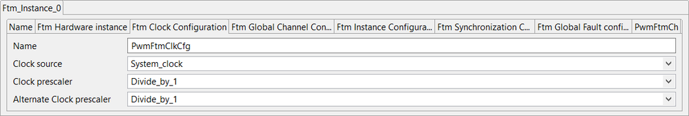

Figure 4: FTM Clock Configuration

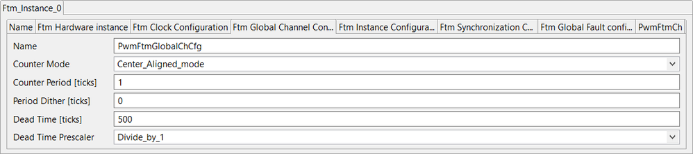

Figure 5: FTM Global Channel Configuration

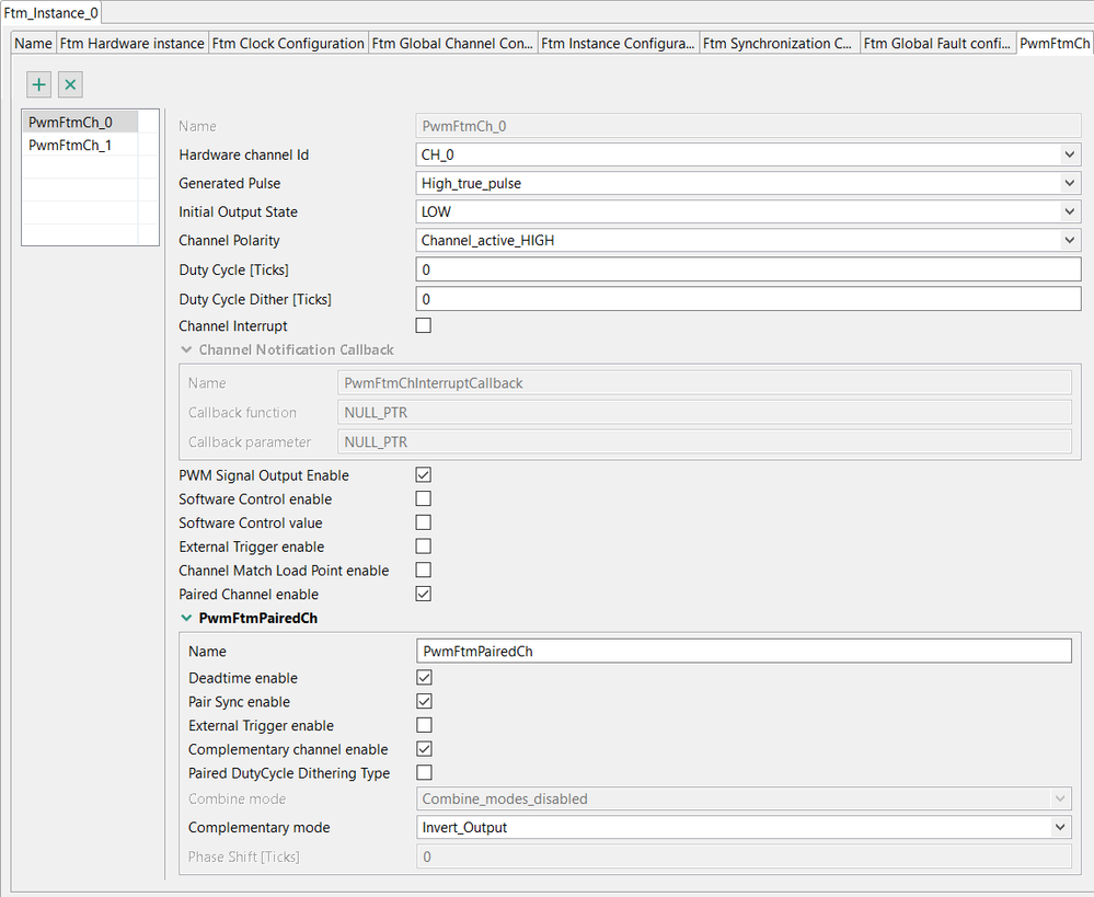

Figure 6: FTM PwmFtmCh (for Ch0 and Ch1)

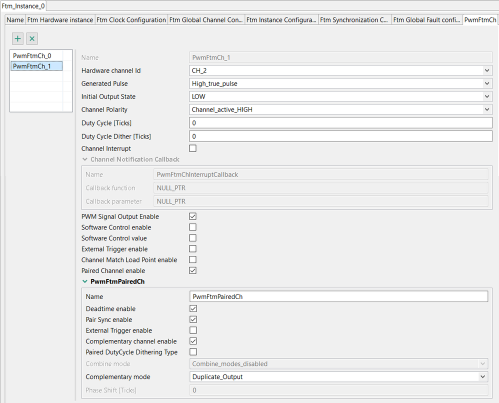

Figure 7: FTM PwmFtmCh (for Ch2 and Ch3)

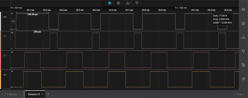

On the oscilloscope
Figure 8 shows that the ftm0_ch0 (D0), ftm0_ch1 (D1), ftm0_ch2 (D2) and ftm0_ch3 (D3) signals on the oscilloscope. Such signals have the same period aligned in the center and with dead-time insertion. ftm0_ch1 is the complementary of ftm0_ch0 with inverted output. And ftm0_ch3 is the complementary of ftm0_ch2 with duplicated output.
Figure 8: Complementary mode and dead-time insertion
