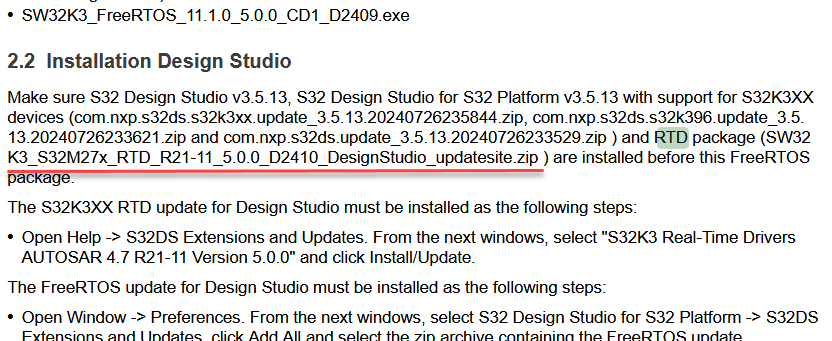

i use s32ds version 3.6, rtd 4.0.0, and s32k344 evb 172Pin board.
i wanna use freertos. so i download freertos and installed.
and i opened freertos example(old version) is toggle Led in freertos. but i can not use old version example in my enviroment.
so i made project, and i configured same with old freertos example.
i build project, and it does not have error and build success.
but when i debug task is not work. because led is not worked.
what is problem?

Hi @rlaxortn,
The FreeRTOS version you use is compatible RTD 5.0.0 which should be installed in the S32DS IDE before the FreeRTOS package, as per the FreeRTOS release notes.
But you use RTD 4.0.0 P20, with this RTD, install SW32K3_FreeRTOS_10.6.0_CD_4.0.0_DS_updatesite_D2312 instead.
I would recommend that you have just one RTD version and its compatible extensions (like FreeRTOS) in a single S32DS installation.
