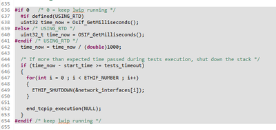

why the mainLoopTask gone while run the lwip_FreeRTOS_s32k396 project for half an hour ,i import the profinet master control code and run the program ,got the below:the #1 task which is mainLoopTask  is missing.

/* If more than expected time passed during tests execution, shut down the stack */
if (time_now - start_time >= tests_timeout)
for(int i = 0 ; i < ETHIF_NUMBER ; i++)
ETHIF_SHUTDOWN(&network_interfaces[i]);
end_tcpip_execution(NULL);

Hello @zhangzhixing ,
Please comment out the entire timeout section in the code, as I typically do when bringing up lwIP examples on various boards:
The variable tests_timeout is set to 1200, which corresponds to 20 minutes. After this period, the code explicitly shuts down the Ethernet interfaces and calls end_tcpip_execution(NULL), which may internally terminate the mainLoopTask.
Pavel
