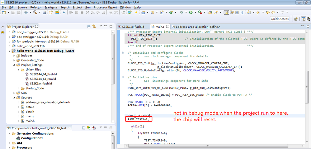

       When l want partion S32K116 RAM ,l find in debug mode, the program is narmal.But without in debug mode,the program run is not naomal and the s32k116 chip reset always.
        l have use the s32k144 and s32k146 two years,l did not meet this problem .

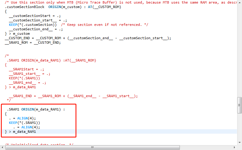

        I think maybe scrip file"S32K1xx_flash.ld" what l setted is wrong.but l  do not know which wrong .l have submitted the problem several days ago,but it did not resolved.the link isHOW to partition S32K116 RAM
       Now, I  will  instruction the problem detailed .
        In debug mode, l  initialize RAM1  area  variable ,the project run sucess.In not debug mode,when the project run to set RAM1 area variable (  RAM1_TEST1=1;), the chip will reset. just as bellow:

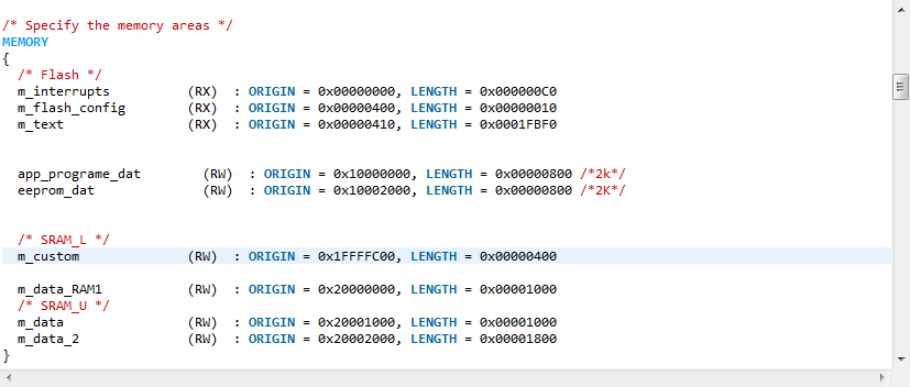

     l think the question is l have setted "S32K1xx_flash.ld" file wrong.please tell how to set "S32K1xx_flash.ld".
the memory setting as follow.
in project ,I add define as bellow
#define SRAM1_STRORG __attribute__ ((section(".SRAM1"))) /* 8k */
#define SRAM1_STRORG_UINT8 SRAM1_STRORG uint8_t
#define SRAM1_STRORGL_UINT16 SRAM1_STRORG uint16_t
#define SRAM1_STRORGL_INT16 SRAM1_STRORG int16_t
#define SRAM1_STRORG_UINT32 SRAM1_STRORG uint32_t
