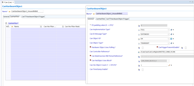

When Enhanced FIFO is enabled, some Mailboxes (MBs) become unusable. I assigned 25 short-cycle messages to Enhanced FIFO for reception, and the remaining messages were assigned to MBs configured in Full or Basic receive mode. However, some receive messages experienced noticeable frame loss, and transmit frame loss was not improved either.

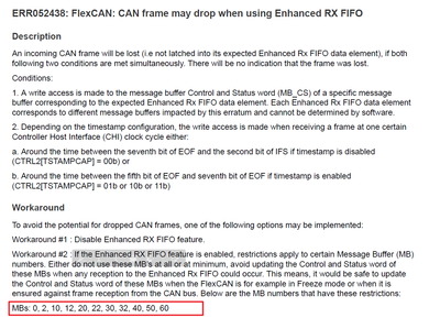

According to the S32K312_0P09C Errata, the MBs affected by Enhanced FIFO must still be configured because the EB tool requires consecutive numbering of MBs. Therefore, I configured those MBs in Full mode, and set the filter code to 0 and filter mask to 0x1FFFFFFF.
Additionally, I observed that after enabling Enhanced FIFO, the interrupt execution time increased from 30 µs to 40 µs, and I'm not sure if this is related to the frame loss issue.
Question 1:
When Enhanced FIFO is enabled, how can the restricted Mailboxes be disabled using EB tresos? For example, if these MBs are used for receiving or transmitting, how should they be disabled or excluded from use?

PetrS
1) as far as i know ERR052438 will be addressed by RTD in next release (6.0.0).
2) using ID masking/filterring single MB can receive all std or ext messages.
BR, Petr

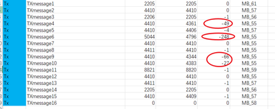

DennyZhang
this picture list transmit lose number, detail log is below file
