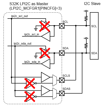

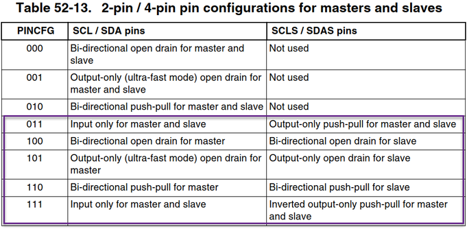

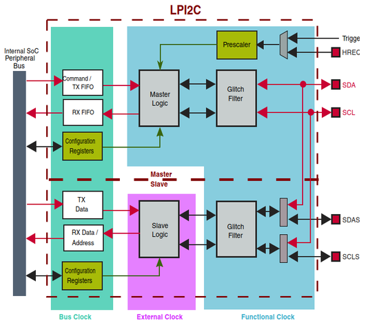

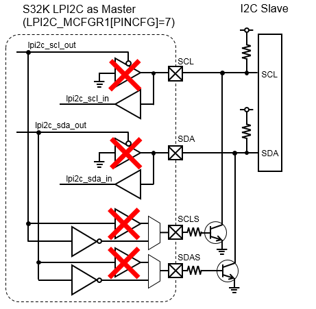

The functionality depends on the configuration of MCFGR1[PINCFG].
PINCFG = 0b011
PINCFG = 0b100 or 0b110
SDA, SCL used by Master
SDAS, SCLS used by Slave
PINCFG = 0b111

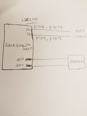

Dear @danielmartynek
Thanks for the response
In our schematic, We are using SCL(PTD14, PTC8) and SDA(PTC9 , PTD13) pins as GPIO
We need to use SCLS(PTB1) and SDAS( PTB0) as I2C  Master( LPI2C0)  - Two wire mode
Is that possible? Please clarify.
Below is the drawing ,
Tagging my colleagues for reference
@LavanyaR
@Riyasma07

Hello @Prasanth_C,
Unfortunately, there is no PINCFG configuration that would allow that.
