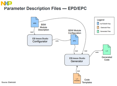

what is the file format of EPC/EPD? in mcal , autosar

what is the abbrevation of .epd .epc in Mcal?

Hi @focusdoit
EPD/EPC files are BSW Module Description/Configuration files (or AUTOSAR module definition file) which can also be used in XDM format.
EPD is the standard AUTOSAR format. This allows the AUTOSAR software to be used with any other AUTOSAR Configuration/Generation tool.
XDM is a proprietary format (EB) providing enhanced usability features during configuration with EB tresos Studio.
Julián
