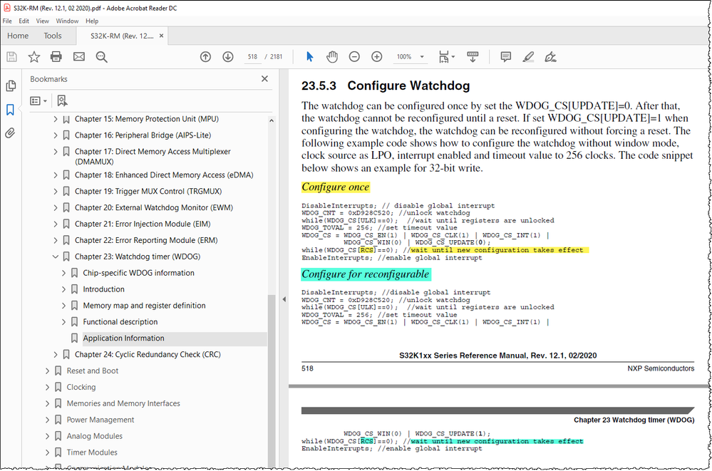

Hi shuwei,
1. Yes. It's necessary.

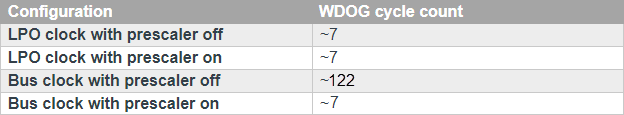

2. The number of cycles it takes for the RCS flag to set should be:
If you want to reduce the wait time, please switch clock source and disable Watchdog prescaler(PRES=0).

DavidShu
Hi Robin,
Thx your suggestion,i choose to close WDG clock prescaler and increase timeout counter. Now the RCS waiting time really decrease to 1/256 of before.
