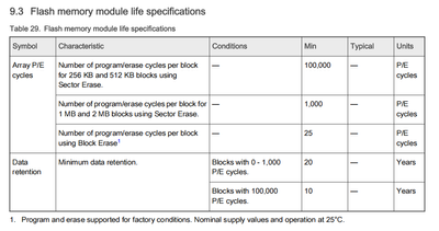

    Hello everyone! At present, the API of C40_ip component is used for the DFlash erase operation in the project. However, I found from the manual that the DFlash and PFlash of S32K314 have a lifespan of only 1000 cycles for sector erase. So I am eager to know how to use NXP approved EEEPROM drivers.

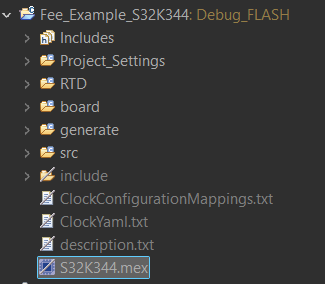

Curent RTD version is 6.0.0.
Example and used drivers are following:
458件の閲覧回数
chaofan
Thank you very much for your answer!

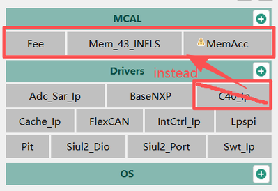

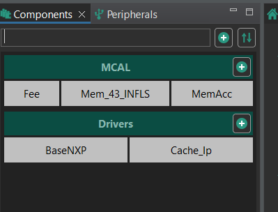

I successfully found this demo in the IDE, and I would like to know if the components of "MCAL" and "Driver" can be mixed together?
If possible, is it feasible to use the three fee components from "MCAL" instead of the "C40_ip" component in "Driver" as shown in the demo? Will there be compatibility issues?
425件の閲覧回数
davidtosenovjan
It is not recommended, you could choose one of these layers.
373件の閲覧回数
chaofan
Thank you for your reply!
So to use the functionality of EEEPROM, is it currently recommended to fully use the "MCAL" component for implementation? For projects that have already developed most of the functionality and fully use the "Driver" component, the workload of porting is a bit heavy.....
311件の閲覧回数
davidtosenovjan
I think it is basically up to you. Fee component will run above flash sections as defined so you can possibly use other section with IP layer, but it is up to you to guarantee coherency.
