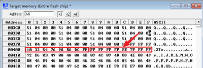

1,Do I need to partition the CSEC for jatg encryption? The flash configuration key was successfully written, but the [sec] register was not successfully written,why?
2,Does this require configuring other encryption functions?

CSEc and "Flash memory security" are two different things.
CSEc is not needed to enable flash memory security via FSEC. It's independent. Also notice that flash memory security feature just restricts the access via JTAG/SWD. It does not encrypt the flash.
