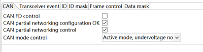

I set CPNC = 1; when I read the register (0x22), the result is 0xc0, Please tell me which registers to set, thank you
1 解答
1,435 次查看
TomasVaverka

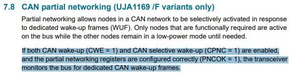

Hi Jason,
Please note that also the CWE bit should be set to 1:
The ID registers (0x27 to 0x2A) should also be configured so that UJA1169 knows which IDs are selected.
PNCOK bit should be set to 1 at the end of partial networking configuration:
I hope it helps.
Tomas

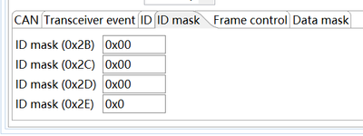

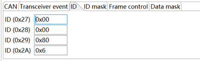

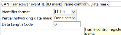

jason_qian_2-1616031346846.pngjason_qian_3-1616031360830.pngjason_qian_4-1616031406856.png
I set the ID is 0x1a0,  Unable to wake up uja1169 when I send this ID once, but When I send it twice in a rowcan wake up  uja1169.   Why do I have to send the ID  twice in a row
