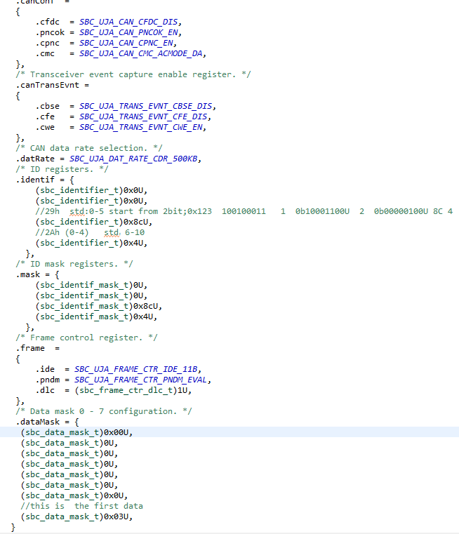

My wake-up-frame consists of ID and data.

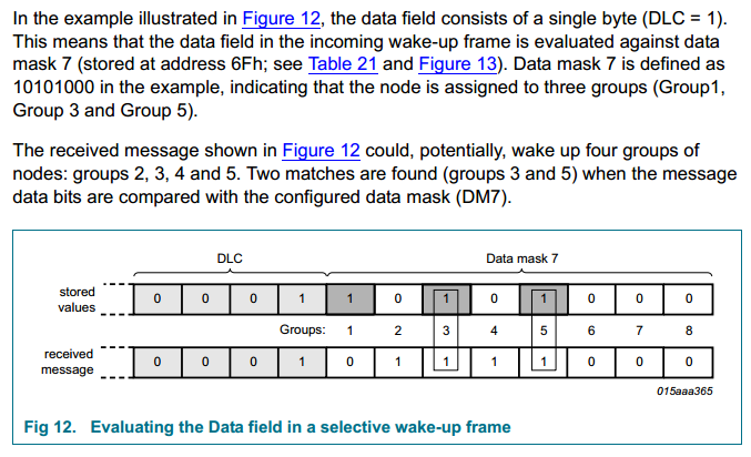

The first problem is that I can't understand  how to use the data function. the Fig1 is the data function's example in the datasheet, but I can't understand what is the Group and why only group 3 and group 5 match.
The second problem is that I have set the related register for wake-up-frame (CWE, CPNC, PNCOK, Std ID,no data so no DM), but when I test the wake-up-frame function, It is strange that all frames can wake up the UJA1169 (I am sure I let the UJA1169 be in stand by mode correctly). For example, the wake-up-frame is std ID 0x123 (PNDM = 0), so I set the ID register 29h to 0x8c, and the ID register 2Ah to 0x04,The ID MASK register (2Bh - 2Eh) are all 0x0, so only 0x123 can wake up the UJA1169 according to the datasheet. But when I test, it is strange that all frames can wake up the UJA1169. Can you help me analyze this problem?

The first problem
It only matches groups 3 and 5 because these are the groups that in both cases are set to 1. This comparison doesn't take into consideration de zeros.

For example,  if the ID is match, then the data mask is 0b0000 0011, so the received message data is 0b0000 0001 or 0b0000 0011 or 0b0000 0010 can wake up the SBC. Is my understanding right?

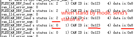

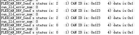

But I have tried this,always, all data can wake up the SBC.The following is my setting, Pls see it.
the other board send ID 0x123, data 0xc or 0x8 or 0x1 or 0x2 or 0x3, they all wake up the sbc from standby mode.
