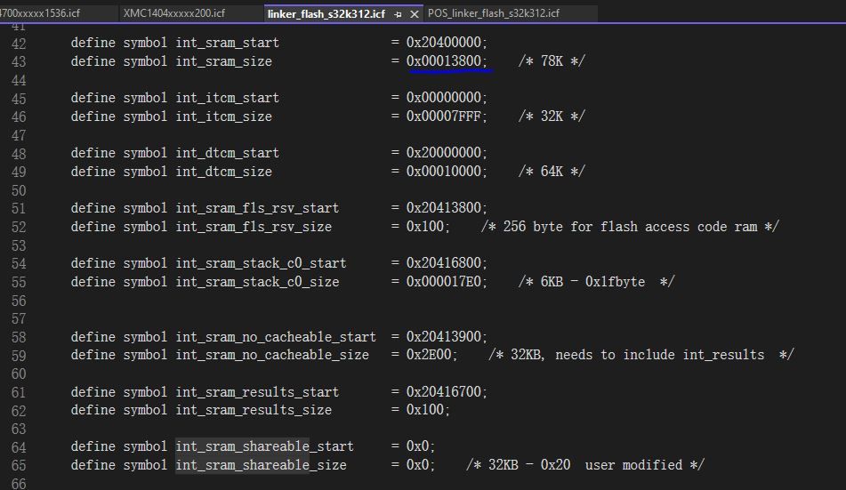

dear NXP experts:
in the S32K312 project, in the ld file ,we can find there is 32K int_sram 、32K int_sram_no_cacheable and 32K int_sram_shareable, could you  pls  tell me the detail distinguish about this classification?

int_sram - no constraints
int_sram_no_cacheable - expected to be non-cacheable (interrupt vectors and other reasons)
int_sram_shareable - expected to be shared with multicore

Hi, @davidtosenovjan
After modifying the sizes of int_stram, int_stram_no-ucacheable, and int_stram_sthareable in the linker file, there is a  Data access violation (CFSR. DACCVIOL, MMFAR), At data address 0x20408594.
The chip is S32K312, and the linker file is as follows
Could you give me some advice? thank you!
