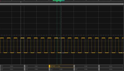

There is a problem about PWM output frequency, the configuration of PWM is as below:
eMIOS_Mcl configuration:
  1. eMIOS_0 source clock is 160Mhz
  2. eMIOS_0 clock divider is 200 and the default period is 65535
PWM channel configuration:
  1. clock prescaler is DIV_1
  2. prescaler clock source is EMIOS_PWM_SRC_PRESCALED_CLOCK
  3. the period is 65534
the frequency of this channel should be calculated by below formula:
output frequency = 160000000 / 200 / 65534 = 12.2Hz
but I got a 3.67hz waveform.
It looks like the source clock divided by 3 once again.
I have double checked the configurations and can't find any clue.
I'd like to know why this phenomenon should occur.
RTD is 2.0.1
S32DS V3.5
Thanks!

your calculation is correct, but in your project the core clock is running from FIRC, not the PLL. This makes that difference.
For clock init use below function
/* Initialize clock */
Clock_Ip_Init(&Clock_Ip_aClockConfig[0]);
BR, Petr

zp001
I tried to read PLL clock via Clock_Ip_GetFreq(PLL_CLK);
The PLL clock is zero, that is inconsistent with the clock map.
