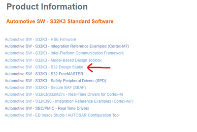

cf_st
Hi Nam,
I have a similar issue but trying to install Linstack updated version 2.0.3 for K3 in S32DS 3.5.
(Error in log
Missing requirement: com.nxp.RTD.S32K396.root.feature.feature.group 3.0.0.202303311831 requires 'org.eclipse.equinox.p2.iu; com.nxp.s32ds.s32k396.dev.feature.feature.group 1.0.0' but it could not be found)
Could you please post a link with the path to the file S32K396_updatesize.zip you mentioned in the thread solution post?
4,422 Views
NamLee
When you try to download the K3 product, instead of enter Realtime-Drivers... please enter to S32DS here
Design : Product Information : Automotive SW - S32K3 Standard Software (flexnetoperations.com)
Thank you,
Nam.
4,426 Views
NamLee
Hi cf_st,
You need to install the Development package for it first, then you can install the RTD package.
I'm not sure that you can enter the link, but please give a try to this link: Design : Product Information : Automotive SW - S32K3 - S32 Design Studio (flexnetoperations.com)
Kindly check the correct Dev Pack that you needed
Thank you,
Nam.
