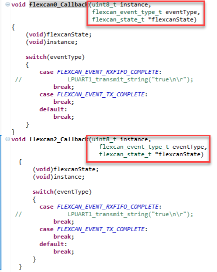

Hello expert,
I debug the example:
I used S32K144 EVM board , and the SDK version is S32SDK_S32K1xx_RTM_3.0.0.
And I use the FreeRTOS_v10_0_1 which comes with the SDK
I use the CAN0 and CAN2but after I initialize the CAN driver( CAN_Init() function) the APP_TASK can not work, the prvCheckTasksWaitingTermination() is executed for ever.  If I disable CAN_Init() function, APP_TASK can work normally.
What may be the reason?
I attach my project.
Could you give me some suggestion?
Thank you very much!

First, I would like to apologize for the late response. I imported your project and I noticed a couple of things that got my attention.
The following warnings.
Your callbacks only receive three parameters.
However, the type flexcan_callback_t receives 4 parameters, you are missing the buffIdx.
Also, in your function CAN_INIT, you are initializing two times the same instance.
