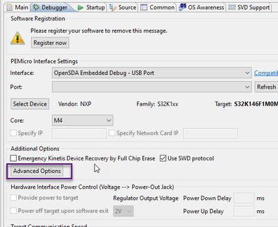

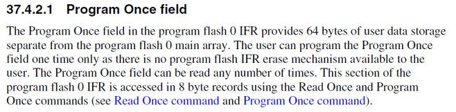

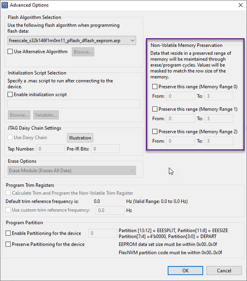

danielmartynek
Hello @d_shivamkumar,
You can use the Program Once field that can't be erased, but there is only 64bytes available.
If you use a PE Micro programmer, the PE Micro Plugin in S32DS IDE allows preserving certain parts of memory during programming.
