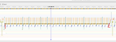

Hello, i have problem with sCheck test XRDC. In Scheck manual is information that XRDC test in worts case shall be executed in 43952us. On my platform s32k322 i have time 180ms.
sCheck_ExecuteStartupTests return = 0 this mean TEST is pass.
Why time execution is too long ? Where i should looking for isiue ?

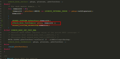

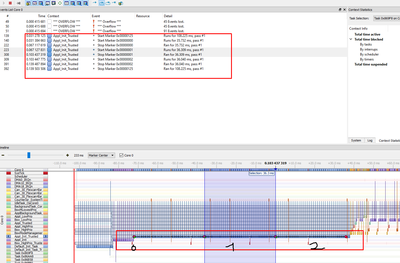

I check XRDC  codes from Your library and under 42ms is testing one DOMAIN, so for 3 domains we got ~100 - 120ms.
I think that this IMPORATNAT information shall be added to MANUAL because it can be confusing.
On screen You can see, that every domain i testing by 35ms
Red dots mean start and stop test on domain 0,1,2.

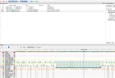

Marekp
I check only when XRDC is enabling in sCheck configuration and time only for XRDC test = 0.139561908s. This is normal ?
