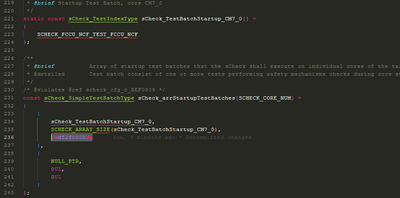

Marekp
Hello

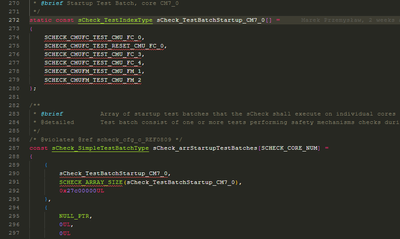

"This is strange, didn't you modify the generated sCheck configuration file?"– No, the sCheck_Cfg.c files have not been modified.
The generated signature for the FCCU_NCF test is: 0xDF2F0000UL
For the purpose of this test, only the FCCU_NCF test is executed.
As an example, I enabled only the following startup tests:CMU_FC_0,CMU_FC_3,CMU_FC_4,CMU_FM_1,CMU_FM_2
The generated signature was: 0x27C00000UL
And the tests completed successfully.
So, does Tresos generate incorrect cfg files for the FCCU test?

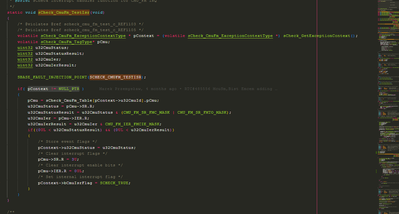

Marekp
Thank you for your guidance. The CMU_FM1 test is now working correctly in both runtime and shutdown phases.
However, I still have an issue with the CMU_FM2 test — it cannot complete during runtime and shutdown.
The interrupt associated with this test (InterruptID = 86) is being continuously triggered,
and the test cannot finish because pContext != NULL_PTR.
As a result, the watchdog cannot be refreshed and a system reset occurs.
Should CMU_FM2 perform any specific action after the test is completed?
This does not seem entirely possible, since the InstallIsr function installed sCheck_CmuFm_TestIsr as the handler,
and the interrupt continues to be triggered indefinitely.
could You help ?

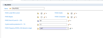

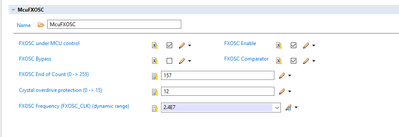

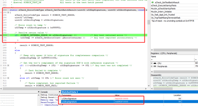

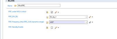

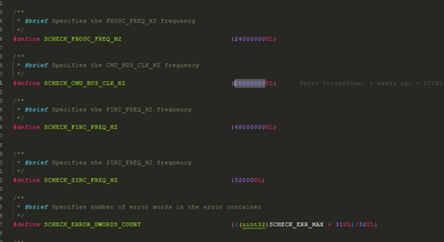

RadoslavB
Hi Marek,
can you do screenshot again from sCheck General Tab to see FXOSC clk and STM clk and then screenshot from RTD how exactly is configured STM instance used by sCheck? These settings must be equal.
And please try to set breakpoint into function sCheck_CmuFm_RunTest() to this line:
pArgs->u32Signature = SCHECK_INTERNAL_ERROR;
and confirm if this line is reached.
Also screenshot how CMU_FM2 registers looks like before the test is executed.
Kind Regards,
Radoslav
1,755 Views
Marekp
Parameters:
FXOSC Frequency- 2.4E7
FIRC Frequency- 4.8E7
Clock Mux0 Divider2 Frequency (AIPS_SLOW_CLK) (dynamic range) - 4.0E7
