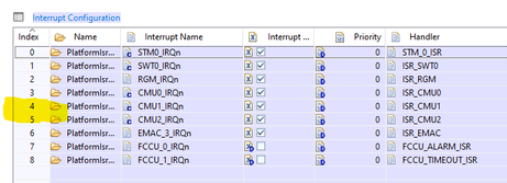

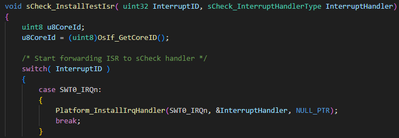

Hi Marek,
are you using EB Tresos MCU plugin?
The MCU plugin supports now only CMU_FC, so there is only this notification:
For CMU_FM interrupt handlers you can register them via Platform plugin like this:
This is not very well documented in RM Interrupt Map XLS either:
CMU_0 is CMU_FC_0
CMU_1 is CMU_FM_1
CMU_2 is CMU_FM_2

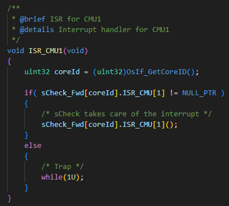

So please register the CMU_FM handlers and do the interrupt redirecting to sCheck handler like for example (snippet from SAF Demo example, see the example for more details if needed):

Thank you for the guidance. I’m using AUTOSAR and managed to configure the interrupt successfully in DaVinci. The StartUp tests for CMU_FC and CMU_FM complete with a positive result. HOWEVER, the RunTime and ShutDown tests for CMU_FM are failing. The processor frequency is 160 MHz. When the StartUp tests are skipped and only the RunTime tests are executed, the result for CMU_FM is still a failure. This situation occurs consistently, even when CMU_FM tests are not enabled for the StartUp phase.

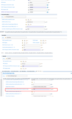

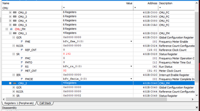

RadoslavB
Hi Marek,
difference between startup and runtime/shutdown is that startup is configuring CMU on its own, but runtime/shutdown rely on CMU configuration from customer app.
From the screenshot it seems that CMU_FM is not configured?
You need to setup CMU_FM via registers according to RM + see notes in sCheck UM - chapter: CMU Tests, especially configure REF_CNT at least 3x above the minimum REF_CNT.
You can explore CMU_FM setting during startup test and configure in a same way for runtime.

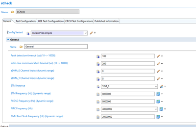

  1. The Runtime test for FCCU_NCF is reporting an error —
    FCCU signature = 0x20C80000
  2. eMCEM is not initialized.
  3. I am basing my implementation on the examples provided in the DEMO.
    Here are the values from the sCheck driver configuration:
    • STM Frequency (Hz) (dynamic range) – 40000000
    • FXOSC Frequency (Hz) (dynamic range) – 24000000
    • FIRC Frequency (Hz) – 48000000
    • CMU Bus Clock Frequency (Hz) (dynamic range) – 16000000
      And clock configuration
8,326件の閲覧回数

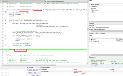

RadoslavB
FCCU_NCF test signature 0x20C80000 represents correct test execution, so sCheck_ErrorCodeType shuld return E_OK. Where do you see a problem?
BTW this test is not possible to configure for runtime phase, only startup or shutdown is possible.
If it's executed via  sCheck_ExecuteStartupTests() you don't need to have eMcem_Init() done, but for shutdown it is required.
One condition is to not configure FCCU with HARD LOCK setting.

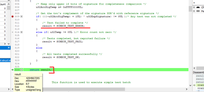

Marekp
Hello Radoslav
Yes of course FCCU_NCF test is exucuted on startup test.
Signature which is returned from function sCheck_ExecuteSimpleTestBatch() is equal
0x20C80000
But function sCheck_GetTestBatchResult() return SCHECK_TEST_ERROR in IF
FCCU is of course NO LOCK
Where to look for the cause of the error?

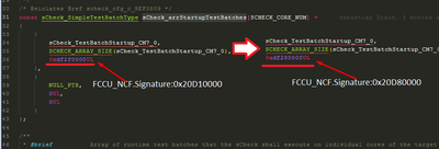

please could you try to modify file
\SafetyBase_TS_T40D34M10I4R0\resource\CORTEXM_S32K3XX_s32k322_hdqfp172.properties
or CORTEXM_S32K3XX_s32k322_hdqfp100.properties (depends on what you have selected in Resource module)
find line with text:
sCheck.Fccu_Ncf_Test.FCCU_NCF.Signature:0x20D10000
and change to
sCheck.Fccu_Ncf_Test.FCCU_NCF.Signature:0x20D80000
Regenerate the project and rebuild project and try the NCF test again please.

Marekp
Hi Radoslav,
Sorry for the late reply.

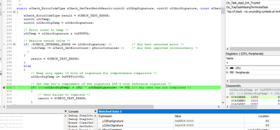

Following your recommendations, I updated the signatures in the file:
"SafetyBase_TS_T40D34M10I5R0\resource\CORTEXM_S32K3XX_s32k322_hdqfp100.properties"
Unfortunately, the issue still persists. The FCCU tests return the result: SCHECK_TEST_ERROR
The result of the XOR operation in line 305 in function sCheck_GetTestBatchResult(...)
(((0x20C80000)+1UL)^0xDF280000)=0x00100000
I also checked the FCCU (scheck) tests — none of them report any errors, so the problem is most likely related to the generated signature.
8,095件の閲覧回数
RadoslavB
Sorry for misleading info, correct signature is 0x20C8_0000.
So, if you can change resource file again with this value, the test should pass.
if you can confirm we will create bug ticket for this.

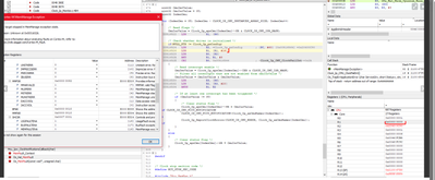

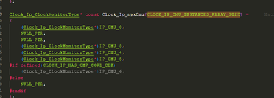

after enabling the MPU for NULL_PTR checking, I’m still experiencing an issue with the CMU_FC and INTM test, specifically in the FOR loop within a function.
During the second increment of the IndexCmu variable, the code attempts to access the IER register, but its value is NULL_PTR.
This happens because on the S32K322 processor, the Clock_Ip_apxCmu[CLOCK_IP_CMU_INSTANCES_ARRAY_SIZE] array only contains valid entries at indexes 0, 3, 4, and 5, while indexes 1 and 2 are defined as NULL_PTR
Shouldn't there be an additional check to verify whether CmuIsrValue and CmuIerValue are not NULL_PTR?

RadoslavB
index 0 and 1 are dedicated for CMU_FM, RTD doesn't support CMU_FM config at the moment.
You need to configure CMU_FM via low level register programming.
You can take inspiration from sBoot code for CMU_FM1 in this file: sBoot_Firc.c
