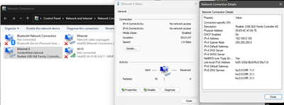

Assuming the link partner of EVB is your laptop. Naturally, you need some  RDDRONE-T1ADAPT: Ethernet media converter | NXP Semiconductors to convert 100BASE-T1 to TX. But to avoid any collision with corporate network, RDDRONE needs to be connected to  some USB-to-Ethernet converter which is set to 192.168.0.100 :

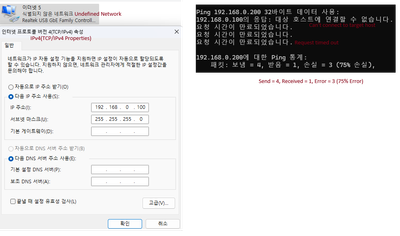

Based on your guidance, I have performed the following steps:
  1. S32K344 Board <--> RAD-STAR2 Media Converter <-LAN to USB-> PC
  2. Changed IPv4 configuration: 192.168.0.10 --> 192.168.0.100
However, the command prompt still shows "Destination Host Unreachable."
What should I do next?

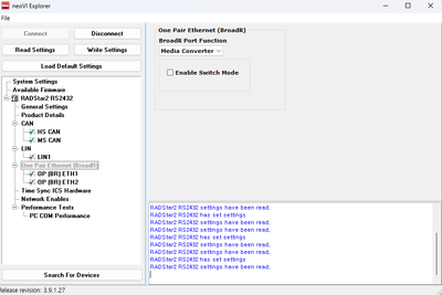

Hello @malove ,
1. please check settings of our RAD STAR2 - it shall be configured as simple media converter (Figure 3, 2. Introduction and Overview — RAD-Star 2 documentation).

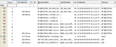

Hello @PavelL
I have set the RAD-STAR2 to simple media converter mode and executed the lwIP sample code.
However, there are some messages appearing in the Vehicle SPY 3 program that I don't understand, although it seems that communication is occurring.
Why is there no response to the ping test?

After completing the setup, I opened the command prompt and ran the following command:
ping 192.168.0.200
However, the result was:
Reply from 192.168.0.10: Destination host unreachable.
Are there any additional factors or settings I should consider in this scenario?

Thanks for all the advice @PavelL .
I changed the media converter settings to make it operate smoothly.
