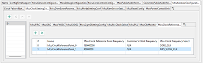

hi, im using s32k344, im trying to build a simple project to toggle a led and use timer as my delay.
i have included GPT as a peripheral and configured the settings of it using gpt_example as a reference, after that i added a clock and gave it 40MHZ as shown below
now im able to toggle the led but the timer on it is not 1 second although i used this function Gpt_StartTimer(GptConf_GptChannelConfiguration_GptChannelConfiguration_0, 40000000);
my channel tick frequency is also 40MHZ .

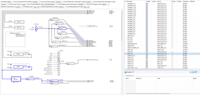

i used the function Mcu_GetClockFrequency(PIT0_CLK); to look at the frequency of the clock i got it as 12MHZ.
this is my clocks diagram :
im also sharing my code , can you please help me with this issue.

Could you change the pin to measure the signal and show an image of it?
From the project attached before, the differences I observed from the Gpt example are:
  • When you call Mcu_Init(), you have defined MCU_PRECOMPILE_SUPPORT as STD_OFF. This causes the function to use the configurations of Mcu_Config_VS_0.
  • The given value to the value parameter (time-out period (in a number of ticks) after a notification or a wakeup event shall occur) is 12000000.
Could you share the image I previously mentioned to verify the signal behavior?
