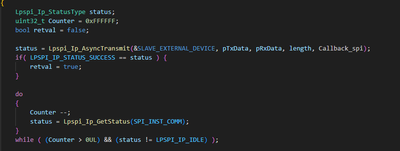

I am testing SPI communication on S32K314.
It was confirmed that the correct data was output through Lpspi_Ip_SyncTransmit.
    status = Lpspi_Ip_SyncTransmit(&SLAVE_EXTERNAL_DEVICE, pTxData, pRxData, length, 1000);
    if( LPSPI_IP_STATUS_SUCCESS == status ) {
        retval = true;
However, even if Interrupt is set, the Finish interrupt does not occur.
        status = Lpspi_Ip_Init( &Lpspi_Ip_PhyUnitConfig_SpiPhyUnit_0_Instance_0 );
        if( status != LPSPI_IP_STATUS_SUCCESS ) {
        IntCtrl_Ip_InstallHandler(LPSPI0_IRQn, Lpspi_Ip_LPSPI_0_IRQHandler, NULL_PTR);
        IntCtrl_Ip_EnableIrq(LPSPI0_IRQn);
    Lpspi_Ip_UpdateTransferMode(SLAVE_EXTERNAL_DEVICE.Instance, LPSPI_IP_INTERRUPT);
So, we are trying to communicate through Lpspi_Ip_AsyncTransmit.
However, correct data is not output through Lpspi_Ip_AsyncTransmit.

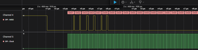

Values ​​0x01, 0x02 ~ 0x20 are being transmitted as test values, but it appears that only the first 3 bytes are transmitted as correct values, and the rest are transmitted as garbage values.
If there is anything you can help me with, please do so.

jwkang
Thank you for the source code. I am referring to it.
Since our project doesn't use MCAL, we don't use Rm.
Is it necessary to use the Cache_Ip_InvalidateByAddr function?
Currently, I am transmitting using the Lpspi_Ip_AsyncTransmit function, but when I read it with Lpspi_Ip_GetStatus, LPSPI_IP_FIFO_ERROR occurs. Do you know how to resolve LPSPI_IP_FIFO_ERROR?
