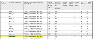

I'm trying to use Temperature sensor of S32K312 MCU
However, the temperature sensor register value is not displayed as T32.
And, If trying to write Tempsense Register ETS_EN(0x4037C000), Os fault occur.
How can i get to Tempsense Register??

I'm using Mcal_NXP_S32K3xx-3.0.0_P01_HF01_Aut03 and GreenHills, Autosar Platform.
I'm trying to use it in an application, not example.
If call the mcal function 'Adc_TempSenseSetPowerMode(ADC_NORMAL_MODE); to enable the temperatrue sensor, Os fault occur, writing TempSense register Address.

I 've resoleved this problem setting PRTN1_COFB2_CLKEN[REQ95] to Turn ON.
