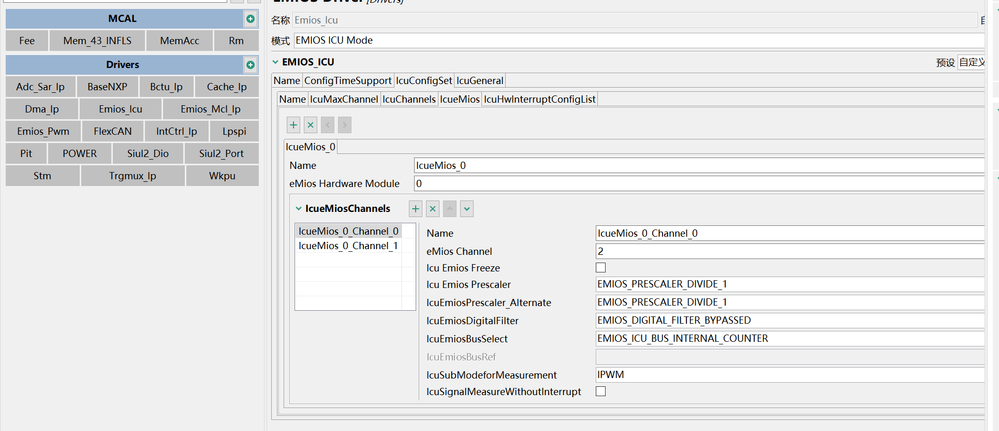

I am using the S32K312 for PWM measurement. I noticed that if the external PWM input signal is disconnected, the measured value retains the state before disconnection. What causes this issue, and how can I resolve it?
8 Replies
1,972 Views
fengba_360
I am using the eMIOS ICU for PWM measurement.
The measurement pin configuration has an external pull-down resistor

If there is no PWM input, there is no edges and therefore no measurement. Overflow (theoretically) should happen, but due to hardware implementation, the Icu Overflow Notification is out of sync with the event for ICU_MODE_SIGNAL_MEASUREMENT, ICU_MODE_TIMESTAMP and ICU_MODE_SIGNAL_EDGE_DETECT modes.
You can perform a solution like in the following post:
https://community.nxp.com/t5/S32K/Measure-input-pulse-measure-with-edge-count/td-p/2075926
Which route the external signal to be measured to a pin configured as trgmux_inX. And then, route its trgmux ouput to a two eMIOS channels, performing different functionalities. One for measurement and the other one to emulate overflow.
Hope it helps you.

The pins aren't fixed, but I still don't want to trigger through the Trgmux module. I want to keep using the current emios_icu method for measurement. Are there any other solutions to address the issue where the PWM signal generator suddenly goes offline, causing the measurement value to retain the previous value?

TRGMUX is the only way that comes to my mind to address such issue. You need one eMIOS channel for measurement and the other one to emulate overflow.
