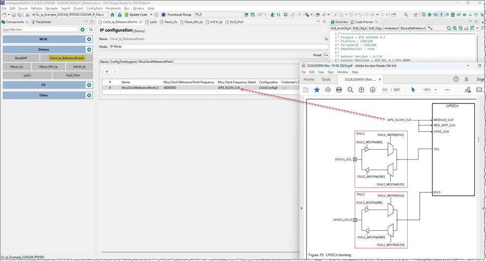

Please add Clock_Ip_ReferencePoints and configure AIPS_SLOW_CLK as the MODULE_CLK source of LPI2C.

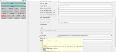

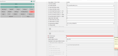

As your guide, I added Clock_Ip_ReferencePoints and set it to AIPS_SLOW_CLK. The problem is that Baud rage is out of spec and causes an error. My target is 400kHz.

Please change the value of LPI2C Master configurations by refer to CALCULATE S32K312 I2C BAUDRATE IN DETAIL.
