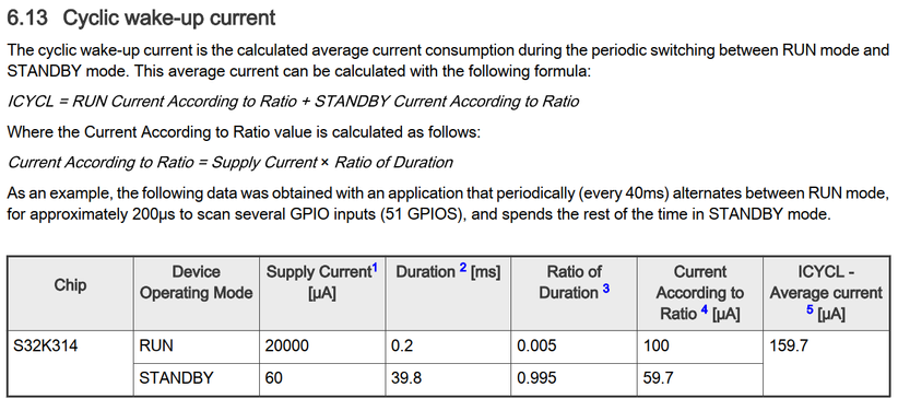

we are using S32K312 uC. can you provide the cyclic current for S32K312.

Hello @mogilipuri_harish,
This has to be calculated for each use case.
In the S32K3xx Datasheet rev.6, there is an example:

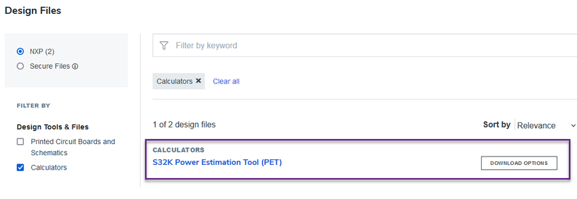

To estimate the RUN and STANDBY consumption in your application, use the S32K Power Estimation Tool (PET).
https://www.nxp.com/products/processors-and-microcontrollers/s32-automotive-platform/s32k-auto-gener...
