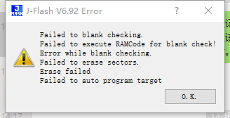

  • The following error occurs when downloading through JLINK:
S32DS2.2  debug in ram is OK
S32DS2.2  debug in FLASH is not OK
board:s32k146
OS:win 10
  • What do I need to do to recover?

Hi@jinsheng20
     It seems that the chip is encrypted and you can unlock the chip. Below are two links that may be useful to you.
A.
https://mp.weixin.qq.com/s?__biz=MzI0MDk0ODcxMw==&mid=2247485716&idx=1&sn=979631aa2385a4e3c7651ee75e...
B.
https://community.nxp.com/t5/S32K/Unbricking-S32K146/m-p/937227
Here is a picture shows how to unlock MCU by j-link command.
