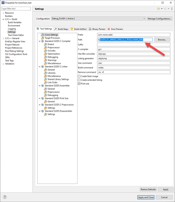

JRoberto
hi @akhilranga,
Thank you for the information. Your problem is the version of the toolchain you are using.
Please check the version on the settings tab by following the steps below.
Open the project's properties
Then under C/C++ Build section you will see the settings path. Please check the version of the toolchain. It should be 9.2 or newer.
Best regards!

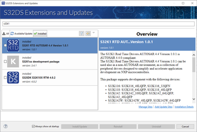

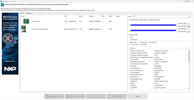

akhilranga
I managed to download the essential SDK for i.MXRT1170 but i couldn't able to get hold of the SDK for the S32k from S32 Design Studio. I already downloaded the IDE. So after that i couldn't able to find where i can add these extensions you mentioned above. Can you please guide me through that.
7,207件の閲覧回数
JRoberto
No problem, actually there is another thread in the community that shows in details how to install the RTD package.
Kindly take a look at:
Solved: S32K1 RTD Extensions for S32DS - NXP Community
And if you have further questions don't hesitate to ask
7,190件の閲覧回数

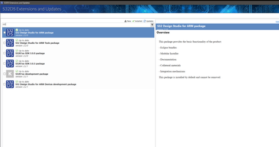

akhilranga
Hi @JRoberto
I have encountered two problems .
After i tried to update my S32DS from version from 1.3 to 2.2. I deleted the previous version and downloaded the new version. This is the pretext of the issue. And now i am having trouble with creating a project from example which i didn't have earlier.
And the second one is now i am able to add the updates and exensions from the pop folder at the beginnig of the IDE boot up process. But couldn't able to find the s32k144 RTD extension. attaching the both Screen Shots to aid you understand the situation.
7,188件の閲覧回数
JRoberto
Hi @akhilranga
I notice 3 things.
1.- You downloaded the S32 Design Studio for Arm version. I'd suggest to download the one for S32 Platform because all the new S32 updates are coming to this last one.
S32 Design Studio | NXP Semiconductors
2.- The name of the project should not contain symbols. The message shows that you are adding an space " ". Also, I'd highly suggest that the path to the working directory does not contain any special character neither.
3.- Regarding to the examples of the S32k144 RTD.- They come with RTD package for S32k1XX package
https://www.nxp.com/webapp/swlicensing/sso/downloadSoftware.sp?catid=SW32K1-RTD44-D
Best Regards!
