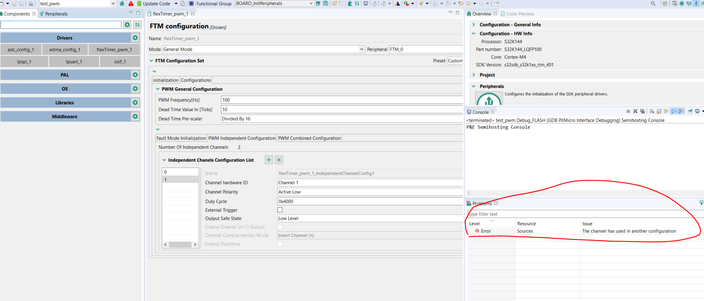

alice_th
hello @danielmartynek
when i set with dead time, ch1 don't have waveform output, could you help to check it
10 回复数
3,061 次查看
Senlent

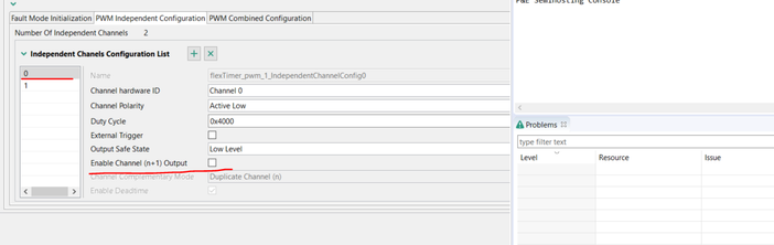

Hi@alice_thanks
I opened your project and you can see that our IDE has prompted you with a configuration error.
you should disable this options as you have already enable ch1
3,048 次查看
alice_th

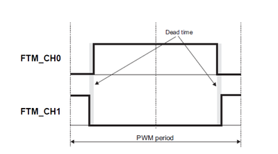

@Senlent hello,
i have question about it, i need below waveform, as my understanding,
i need enable channel(n+1) output with deadtime setting with duplicate channel(n)
if disable it , how can achieve it ?
or can you help modify the project , thnaks !

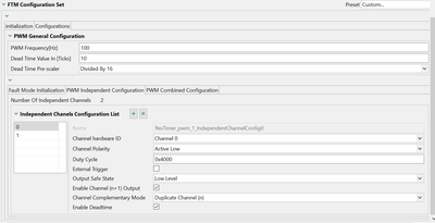

alice_th
hello @Senlent
i just set larger deadtime, i see the delay, for combined it only support invert waveform, how to generate duplicate channel(n+1) ?
and the combined  only support Adjacent channel, if i need with ch0, and duplicate/invert channel 3 or channel6  with deadtime setting.

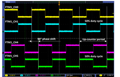

alice_th
@Senlent
i tested the AN code, have some questions about it
void Phase_Shifted_PWM()
SCG_Init();
HSRUN_Init();
    /* Enable clock for FTM1 */
    PCC->PCCn[PCC_FTM1_INDEX] = PCC_PCCn_PCS(6) | PCC_PCCn_CGC_MASK;
    /* Enable clock for PORTB */
    PCC->PCCn[PCC_PORTB_INDEX] = PCC_PCCn_CGC_MASK;
    /* Enable clock for PORTD */
    PCC->PCCn[PCC_PORTD_INDEX] = PCC_PCCn_CGC_MASK;
    PORTB->PCR[2] = PORT_PCR_MUX(2); // Set PTB2 for FTM1 � Channel0
    PORTB->PCR[3] = PORT_PCR_MUX(2); // Set PTB3 for FTM1 � Channel1
    PORTD->PCR[8] = PORT_PCR_MUX(6); // Set PTD8 for FTM1 � Channel4
    PORTD->PCR[9] = PORT_PCR_MUX(6); // Set PTd9 for FTM1 � Channel5
    /* Enable combine, complementary mode and dead-time for channel pair CH0/CH1 and CH4/CH5 */
    FTM1->COMBINE = FTM_COMBINE_COMBINE0_MASK | FTM_COMBINE_COMP0_MASK | FTM_COMBINE_DTEN0_MASK
          | FTM_COMBINE_COMBINE2_MASK | FTM_COMBINE_COMP2_MASK | FTM_COMBINE_DTEN2_MASK;
    FTM1->CONTROLS[0].CnSC=FTM_CnSC_ELSB_MASK; // Select high-true pulses
    FTM1->CONTROLS[1].CnSC=FTM_CnSC_ELSB_MASK; // Select high-true pulses
    FTM1->CONTROLS[4].CnSC=FTM_CnSC_ELSB_MASK; // Select high-true pulses
    FTM1->CONTROLS[5].CnSC=FTM_CnSC_ELSB_MASK; // Select high-true pulses
    /* Set Modulo (10kHz PWM frequency @112MHz system clock) */
    FTM1->MOD = FTM_MOD_MOD(11200-1); // Set modulo
    FTM1->CONTROLS[0].CnV=FTM_CnV_VAL(2800); // Set channel Value
    FTM1->CONTROLS[1].CnV=FTM_CnV_VAL(8400); // Set channel Value
    FTM1->CONTROLS[4].CnV=FTM_CnV_VAL(5600); // Set channel Value
    FTM1->CONTROLS[5].CnV=FTM_CnV_VAL(11200); // Set channel Value
    FTM1->CNT = 0;         // Counter reset
/* Insert DeadTime (1us) */
FTM1->DEADTIME = FTM_DEADTIME_DTPS(3) | FTM_DEADTIME_DTVAL(7);
    FTM1->SC|=FTM_SC_CLKS(1)|FTM_SC_PWMEN0_MASK|FTM_SC_PWMEN1_MASK|FTM_SC_PWMEN4_MASK
        |FTM_SC_PWMEN5_MASK; // Select clock and enable PWM
    while(1);
which part is phase shift setting ?
CnV i think is  duty cycle , 2800 25% 8400 75% duty cycle, why waveform is 50% duty cycle

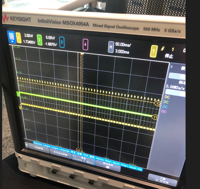

alice_th
when disable dead time setting , both ch0 ch1 have waveform output,
for ch1 there is nothing change, could you please help check the project i have already attached ?
