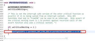

S32K144 transplant FreeRTOS, enter DMA interrupt program stuck in  configASSERT( ( portNVIC_INT_CTRL_REG & portVECTACTIVE_MASK ) == 0 ),As shown in the figure below
PortNVIC_INT_CTRL_REG changes from 0x400000 to 0x400813, DMA priority set to 13, The configMAX_SYSCALL_INTERRUPT_PRIORITY and configKERNEL_INTERRUPT_PRIORITY Settings are shown in the following figure
How should solve this problem, ask ace to help, very grateful

what is called in DMA interrupt?
Lukas
2,640 次查看
ananan
the SPI is called,and the vPortEnterCritical is in this SPI,you mean that the vPortEnterCritical can not be called in the DMA interrupt?
